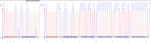

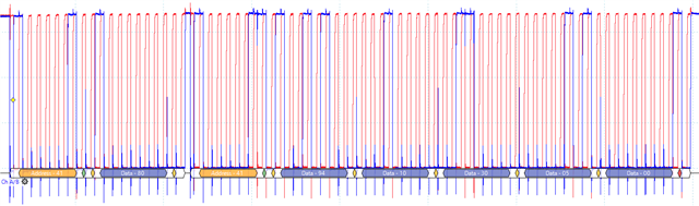

I have issues reading out the CRC in all modes. I will only cover the standard pattern for now 7.5.1.3.3 :

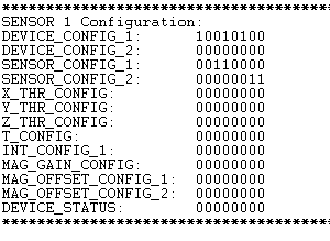

Here is my configuration of the device:
SENSOR 1 Info:
I2C_ADDRESS: 0x41
DEVICE_ID: 0x02
MANUFACTURER_ID: 0x5449
SENSOR 1 Configuration:
DEVICE_CONFIG_1: 10110100
DEVICE_CONFIG_2: 00010000
SENSOR_CONFIG_1: 00110000
SENSOR_CONFIG_2: 00000101
X_THR_CONFIG: 00000000
Y_THR_CONFIG: 00000000
Z_THR_CONFIG: 00000000
T_CONFIG: 00000001
INT_CONFIG_1: 00000001
MAG_GAIN_CONFIG: 00000000
MAG_OFFSET_CONFIG_1: 00000000
MAG_OFFSET_CONFIG_2: 00000000
DEVICE_STATUS: 00000000
So I write to the Address 0x41 and the register (0x10 + trigger ) 0x90
And then the read of 5 bytes. The 5th byte is not the CRC. it is the next register in line.
Lets hope the scope image gets the proper resolution.
Please help!

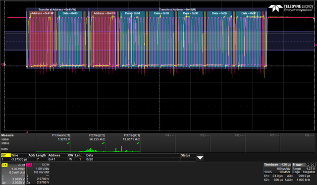

    So you say that I'm reading more than 4 data bytes? ref img. Please advice

    No, in the initiated post I'm trying to describe a standard pattern (3 byte -> [Address] + [register & trigger] + [Address , read bit]). Not the 1 byte I2C read (8-16). How do you believe the INT_Mode is related to the CRC byte? I'm receiving updated conversion using the trigger bit and standby mode.

    Thank you for clarification.  You are correct, INT_MODE is not relevant here, I saw INT pin in the trigger_mode field field and subsequently conflated Int_mode with standby mode.  Your register settings appear to be correct.  It looks as though you might have updated the i2c scope shot as I previously downloaded an image with a secondary address of 0x41 from your original post and the image display now has a secondary address of 0x35.  As you noted, there does seem to be something wrong with the CRC. If I use the crc calculation method presented in the datasheet for the 4 data bytes (0x44, 0xF0, 0x00, 0x1E) leading up to the CRC byte, I get 0x24, which is different than the 0x00 returned.  I do not see a anything in the transmission to justify an error in the CRC.
    You mentioned previously that it looks like the byte that should be the CRC is actually the data from the next register in the register map.  Reading successively from T_MSB, T_LSB, X_MSB, and X_LSB, this would be Y_MSB.  I presume you confirmed this from subsequent transmissions.  Can you confirm?

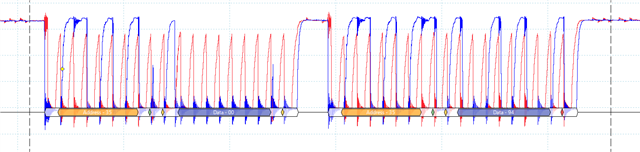

    Yes, the prev img was taken with our PCB. It has too long rise time. Consequently, the frequency is lower than the configured 1Mbps. The CPU waits for the signal to rise above the threshold before doing the drop. The replaced img from the initial post is taken with the EVM and it is configured with a lower std frequency.
    >Can you confirm?
    Yes, I can confirm that it is the next register when reading through all the registers.
    The 3 byte standard read, is it suppose to send CRC on the 5 byte regardless of the requested register?

    We do not expect the slow rise time to be the issue and if it was it should affect all the data and not just the crc.  We have tried duplicating your results and are getting the expected CRC values.  Can you provide a scope shot of a standard 3-byte I2C read starting at register 0h?  This will confirm that your configuration registers are properly set up yet yielding irregular results.

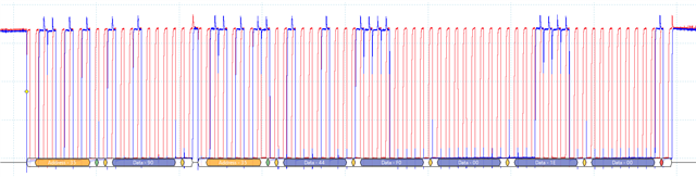

    Here is the scope shot of the 3-byte I2C read starting at register 0h, 1MHz:
    Can you please provide the configuration you are using and a scope shot of the successful 3-byte CRC read back?

    Thanks for the source code. I finally had the time to get your program up and running on the SCB. I installed the code composer and the env - sdk for the cpu and changed the I2c startup configuration to i2c2 for pn4 sda and pin5 scl. Maybe some sensor detection stuff that went wrong (ref TMAG5x73EVM2.zip).
    I used the DFU to update the program. (ref User’s Guide TMAG5x73 Evaluation Module -  slyu058c.pdf 4.1.2.1 - Updating Firmware on SCB) serial bsl or short DFU TP's. The bootloader fails status(11) = iString indicates a vendor specific error, but the LM Flash Programmer downloaded and verified successfully.
    And here's the shot:
    So Finally a CRC!
    There are some difference in the request (its requesting 5 b). You didn't get 5 b request in your scope shot so I guess it's not related? Otherwise there are some gap in between each 8 b. I will try to adapt to get the same behavior. I let you know how it goes.
