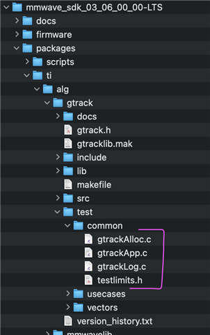

  • gtrack_log  defined in gtrackLog.c
    gtrack_alloc, gtrack_free are defined in gtrackAlloc.c
    These functions are needed to implement at the application level, please refer gtrack test application.
    Based on this reference, you need to include this in your vision_sdk application.
    And I recommend to use this library from the latest SDK version.
