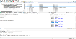

I have tried to re-compile and download application image of OOB demo inside sdk version 4.4.0.1
However, it was not able to run on 2944EVM revision B. It has been stuck at the application image. And I found that RadarSS firmware bin file seems to be corrupted, only 5KB. ("C:\ti\mmwave_mcuplus_sdk_04_04_00_01\mmwave_dfp_02_04_08_01\firmware\radarss\xwr2xxx_radarss_metarprc.bin")
Is there any problem with this sdk release? I copied radarss bin file from older version to replace this bin file. And everything seems to work fine.
Can you please confirm if any problem with this sdk release? Or this release only for 2944 revision D (production version?)
