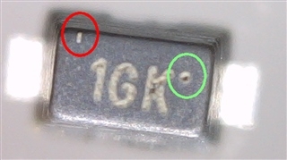

How can we determine the polarity, see below picture and screenshot from datasheet.
Is the marking in the red or green circle?
Hello Frank,
Please see the post below. The dot to the right of the date/lot code is the pin 1 indicator(green circle).
