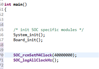

Hi, iwrl6432 teams  now sdk  I used  is 5.2 (latest)
How to set the frequency of the CPU?
I did not find any options set in SysConfig.
But I found a function SOC_ RcmSetM4Clock()
I use it to set CPU to 40MHz
The But log still shows that the CPU is 160MHz, which seems to be not working.
    I have tested this on my end and it appears that you are correct, SOC_rcmSetM4Clock does not appear to be working. I will inquire about this with our SDK team to see if we can get this fixed in a future update.
    In the meantime, if you need the M4 clock to be 40MHz you should be able to use SOC_rcmSetM4ClockSrc(SOC_RcmM4ClockSource_OSC_CLK). I have tested this myself and it seems to be working.
