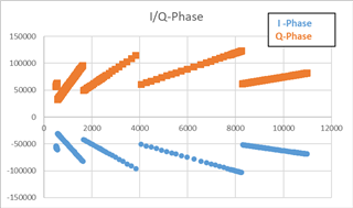

I'm currently evaluating the precision of distance measure in weak amplitude.
I've took the raw data of I/Q-Phase and was expecting some linear data.
But they appeared like this:
(x-axis: amplitude; y-axis: i/q-phase)

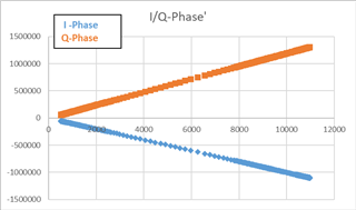

And I was expecting this:
How to get the scale of the raw I/Q-Phase so I can adjust them to be linear over the amplitude like the graph above?
  • Hi Moses,
    Are you varying the distance in order to change the amplitude reading? Also, where are you getting the I/Q values from? The result will be reported in amplitude/phase format, are you converting from polar to cartesian to get this data?
    Thank you,
    Brent Elliott
  • I slide the target from lighter surface to darker surface to get a continuos data from strong amplitude to weak amplitude.
    I set IQ_READ_DATA_SEL to 2 for reading raw I/Q phase and read the raw value from register at 0x3B and 0x3C.
    I want to calculate the phase from raw I/Q-Phase and see how the phase changes if some offset is introduced to I/Q-Phase.

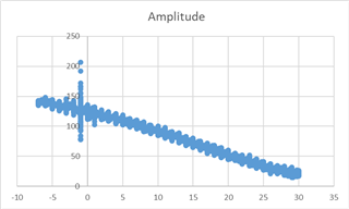

    But even when I set all the register value well, the xtalk (amplitude when tx/rx is covered) increased repidly when I cool down the temp.
    (x-axis: Temp; y-axis: Amplitude)

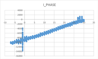

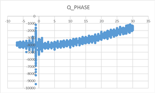

    And I/Q-Phase increased as well when the temp is down.
    (x-axis: Temp; y-axis: I_PHASE/Q_PHASE)
    Is there any action need to be taken to scale I_PHASE_XTALK/Q_PHASE_XTALK back to correct value after adjusting FORCE_SCALE_VAL?

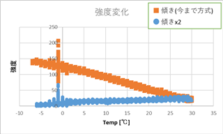

    Since this is about illumination crosstalk temp correction. I'm wondering if the scaling method in sbau310, 4.2.4 is correct or not.
    I've tried to doubled the slopes and the xtalk became well calibrated (as shown in following blue line).
    Doubled the slope makes the orange line become blue line which looks well calibrated.
    Since I have no clue about why doubling the slopes makes the xtalk calibrated. Maybe something wrong on the calculation mentioned in sbau310, 4.2.4, or maybe some other reason.

  • I increased the FORCE_SCALE_VAL to 1 at the beginning and then start running full xtalk calibration over temp. After the I_PHASE_XTALK/Q_PHASE_XTALK over temp are collected, should I scale I_PHASE_XTALK/Q_PHASE_XTALK by 2^1 when calculating the slope (IPHASE_XTALK_REG_HDRi_TXj/QPHASE_XTALK_REG_HDRi_TXj) ? Or just use the original I_PHASE_XTALK/Q_PHASE_XTALK value for slope without scaling?
    If I just use the I_PHASE_XTALK/Q_PHASE_XTALK value for slope without scaling, the calibrated result will be the orange line:
    The crosstalk increases when the temp decreases, which means it is not well calibrated.
    So I'm wondering if my method is correct or not.
  • Hi Moses,
    I'm not sure why exactly the I/Q phase results are not being scaled automatically, but you should calculate the slope using the scaled values so you get the blue line, since the blue line is a good calibration.
