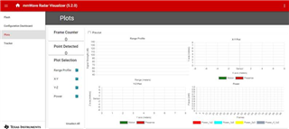

Our customer is evaluating “Presence Detection Demo” with IWRL6432BOOST, they’re encountering the following issue. this means, the point cloud is not displayed. I attached customer’s cfg file (MyPD.cfg). The terminal log is as follows.

Can we have any advice/comments on this, please?
Their environment is as follows.
Visualizer version.: MMWAVE_L (Version: 05.02.00.02)
Cfg file which customer uses: MyPD.cfg (I attached it to this email)
Baud-rate: 115200
Maximum unambiguous range: 20 m
Sampling Rate: 5.0 MHz
Sweep time: 25.6 msec.
Bandwidth: 0.41 GHz
Chirp Start Freq.: 61.0 GHz

    First of all, please collect me some points because I have misunderstood. Customer is evaluating  “Presence And Motion Detection” Demo. I tried to this demo by default, and I confirmed this demo is working fine. And then, I re-tried to do this demo with customer’s config file. As the result, visualizer seems to stop as follows. But, it did not freeze. And then, I loaded the default configuration by pushing “Send Selected configuration” button, and I confirmed this demo is working fine again. This means, it seems customer’s cfg file has some issues. Customer does not modify demo source code. Can we have your expert’s advice/comments on this customer’s cfg file(0726.MyPD.cfg), please?

  • Hi Josh,
    Yes, this issue was resolved with this config file(MyPD_with_minorState_update.cfg). It looks like the original cfg file did not have the “minorStateCfg” with the thresholds setup for the 20m config.
