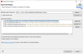

In CCS, go to "Projects>Import CCS Projects", and browse to the example directory that you want to import (people tracking in this case) within the radar toolbox: "radar_toolbox_1_10_00_13/source/ti/examples/People_Tracking". Once you select this directory, you will see the importable discovered projects appear.
Luke
In that path, 6843 project could be imported.
But there is no project for IWRL6432.

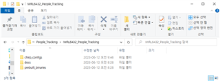

I can't see "src" folder at "C:\ti\radar_toolbox_1_10_00_13\source\ti\examples\People_Tracking\IWRL6432_People_Tracking"
Please refer to this guide in the toolbox: IWRL6432 People Tracking. You can see in step two of this guide that the lab you want to import is <MMWAVE_SDK5_INSTALL_DIR>\examples\mmw_demo\motion_and_presence_detection. Import this project into CCS and follow the steps of this guide to perform people tracking on IWRL6432.
