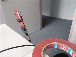

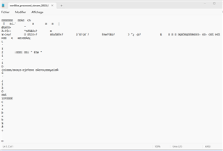

  • Hello Kristien,
    Excuse my delayed answer. I will split it in 3 parts :
    1) First of all, the .dat file generated is completely incomprehensible (see image bellow).
    2) For the time being my problem is still not solved, for example for the obstacle on the image which is at a 10cm distance from the radar, I get the following point on the mmWave Visualizer : (0.3384624 , 0.9246166).
    I made sure it is the right point by identifying the detected points before and after adding the object.
    If I calculate the range of this object, I get around 0.98m which is absolutely wrong.
    I have tested many other objects at different positions and the result is always incoherent.
    3) When using the mentionned code to retreive this data, I get the exact same values as the mmWave Visualizer which means that :
    * The code side can be assumed correct and the troubleshooting is in the radar side.
    * The z axis is never taken into account even if the object is not in the X-Y plan.
    PS : thank you for your answer in the other thread, effectively it was a matter of endianness and I was able to find the correct structure of the data.
    Hoping to get answers.
    Lilia.
  • Hey Lilia,
    The .dat file is encoded and cannot be read by a text reader. It would have to be imported back into a JavaScript application using the correct stream decoder to be read properly. For now, I would recommend ignoring my previous recommendation to use the exported data, as it would likely make things more complicated, and it seems that you are retrieving accurate data points. I apologize for making that suggestion.
    As for the incorrect detected point positions, it appears that the antennas are not directed towards the object of interest. For more information on the axes for the antenna, see Section 4.5 xWR6843AOPEVM Antenna of "60GHz mmWave Sensor EVMs" linked below. Figures 4.7 and 4.8 - shown below - should help you orient the antennas properly.
    https://www.ti.com/lit/pdf/swru546
    The lack of z-axis data is likely a result of the configuration used in the demo which may be telling the device to exclude z-axis measurements - though this shouldn't be the case. Could you attach a text file with the console output and save the config you're using and attach that as well? I might be able to determine why the z-axis measurements are missing by parsing through the config file at the very least.
    Kristien

  • Hey Lilia,
    It appears that the bit mask for the transmit antennas was set to only enable the two azimuth antennas (0x5) under channelCfg for the second parameter. This should be changed to 7 to enable all three transmit antennas including the elevation antenna which will measure the z-axis points. For more information on the configuration files, you can find it in section 3.4 of the MMWAVE SDK User Guide. This can be found by navigating to the following directory:
    C:\ti\mmwave_sdk_03_06_00_00-LTS\docs\mmwave_sdk_user_guide
    If you would like to test to make sure all three transmit antennas are working, select an antenna configuration with three transmit antennas for xWR68xxAOP platform in the mmWave Demo Visualizer and check to make sure 3D data is being received in the plots tab. You can also take a look at the profile_2d.cfg and profile_3d.cfg files stored in C:\ti\mmwave_sdk_03_06_00_00-LTS\packages\ti\demo\xwr68xx\mmw\profiles to better understand the general configuration process used in 2D and 3D applications - though I would recommend looking over the configuration commands in the user guide beforehand.
    Let me know if there are any other issues.
    Kristien
  • Hello Kristien,
    I am finally retrieving z data, I'd like to thank you for your assistance.
    Your answer resolved the problem.
