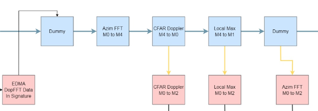

There are several dummy HWA paramsets in DDMA doppler processing stage.  Hope its functionality could be better explained.
I get below pic from  file:///C:/ti/mmwave_mcuplus_sdk_04_04_00_01/mmwave_mcuplus_sdk_04_04_00_01/ti/datapath/dpu/dopplerprocDDMA/docs/doxygen/html/index.html
Could you pls help with below confusion?
Dummy paramset trigger type is EDMA , Azim FFT paramset trigger type is immediate.
EDMA DopplerFFT DATA in signature channel triggers dummy paramset. Why does it not trigger Azim FFT directly?
