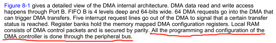

2. What does "Peripheral Bus" refer to? Does it refer to APB or AHB or other bus?

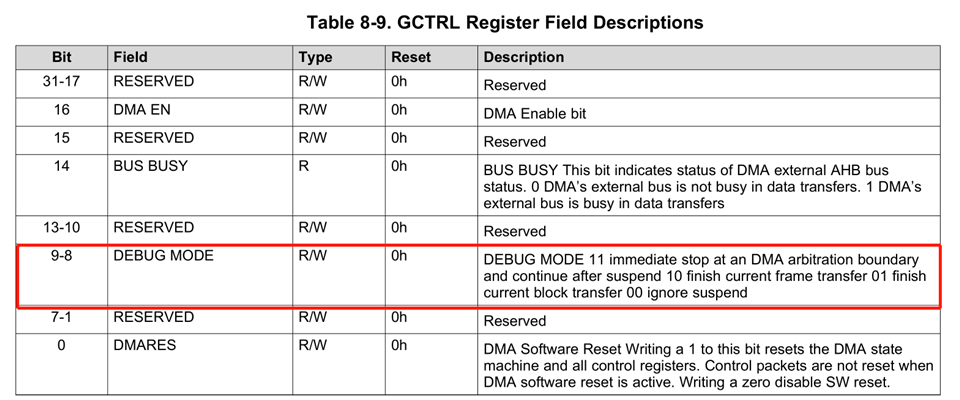

3. How does the GCTRL. DEBUG MODE bit work with CPU? Or is it only controlled by DMA hardware?

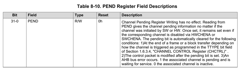

4. When is the PEND bit in channel PEND register set to "1"?

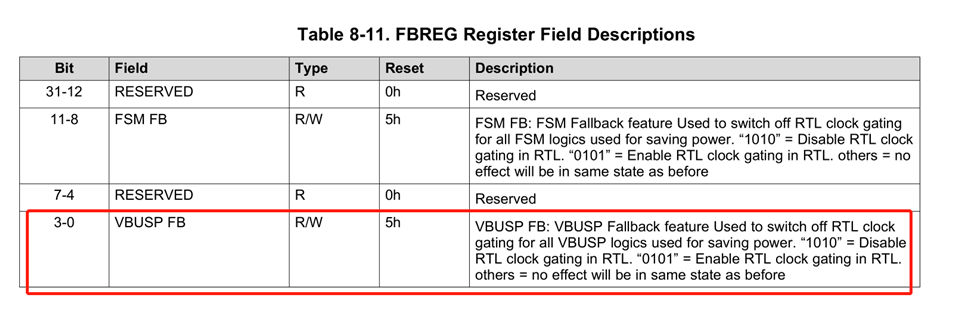

5. What is the working scheme for VBUSP FB clocking gating? Is there some relationship between FSM FB and VBUS FB clock gating?

    Then,I have another question about the port B. How does the Port B connect to the external Bus Matrix?  Can I understand the read and write singal wires are differently connected to the external bus, that is the read and write are controlled by two sets of control signals, such as two sets of haddr/hwrite/htrans/hsize?
    LS.K
