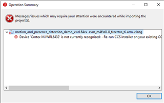

I got error while importing project :- Presence and Motion Detection
D:\ti\radar_toolbox_1_10_00_13\source\ti\examples\Presence_and_Motion_Detection\src\xwrl6432
I installed mmWave_SDK5 :-www.ti.com/.../MMWAVE-L-SDK
Darshan
  • Hi Darshan,
    Please make sure you have the latest version of CCS, as well as try and import the project from the SDK and not the Toolbox:
    MMWAVE_L_SDK_05_02_00_02\examples\mmw_demo\motion_and_presence_detection
    Tim
  • Hi Tim,
    Yes, It's working after updating CCS. It's require latest version of CCS IDE.
    Thanks for support.
    Importing project from mmWave SDK5 and showing that .syscfg file in the project. But not showing in mmwave_sdk_03_06_00_00-LTS and Radar tool box.
