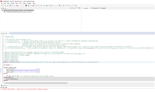

  • Hello Brent,
    I received the launchpad today. Contrary to the description, after connecting the launchpad to the USB, only a Readme file is available in its USB drive. Unfortunately, I am unable to flash any firmware onto it. When attempting to do so, CCS displays the message "TI MSP430 USB1/MSP430: Target must be connected before loading program."
    Thank you,
    Thomas Behnke

  • Hi Brent,
    I have started the flashing tool and then tried again to debug or flash the launchpad with Code Composer Studio. In both cases, I received an error message. (See screenshot)
    Thank you,
    Thomas Behnke

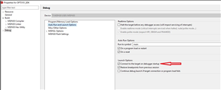

  • Hello Brent,
    I have managed to connect and debug the launchpad with OPT3101. (There was a missing setting in the options). Perhaps you can guide me on where in the source code I can access the data for amplitude and phase in order to calculate distance on the embedded side. I then plan to turn on an LED when a certain distance threshold is reached.
    Thank you in advance.
    Thomas
