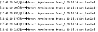

    Thanks for your advice, I change the Misc fault bit  to bit0  and change the fault injection called position to that before rlSensorStart in function MMWave_startLink.  The async event RL_RF_AE_MON_DCC_CLK_FREQ_REPORT have already been reported in mmwave eventFxn callback.
    When async event is detected  I want to clear this fault injection, but my code doesn't work and this async event should be reported continuously. the report info is showed as picture:
    My stop code is showed as below:
    void fault_injection_clear(void)
        rlReturnVal_t ret = 0;
        rlAnaFaultInj_t rlAnaFaultInjection = { 0 };
        rlAnaFaultInjection.miscFault = 0x00;
        ret = rlRfAnaFaultInjConfig(RL_DEVICE_MAP_INTERNAL_BSS, &rlAnaFaultInjection);
        if (ret != 0)
            test_print("return %d\r\n", ret);
            DebugP_assert(0);
    static void mmwDemo_mssSocMonitorTask(void* args)
        while(TRUE)
            if(fault_inject_event_occur == 1)
                fault_inject_event_occur = 0;
                fault_injection_clear();
            vTaskDelay(SOC_MONITOR_TASK_DELAY);
    This function is called in a independent task and the return value of rlRfAnaFaultInjConfig is 251: RL_RET_CODE_FRAME_ONGOING. According to the error description, should  the disable fault inject operation be called when frame is not ongoing? Please give a official conclusion.
    Others, I called fault_injection_clear after frame end and the return value of rlRfAnaFaultInjConfig is RL_RET_CODE_OK, but the phenomenon that async event reported continuously also exist.  After I change the param reportMode of struct rlDualClkCompMonConf_t from 2 to 1, the async event will be only report once. so what is the difference between value 1 and  value 2.
                    "1      Report is send only upon a failure (after checking for thresholds) \n"
                    "2      Report is sent every monitoring period with threshold check. \n"
    After I clear the fault injection, How can I know if the fault have been clarified ?
    Could you please give some advice for the above questions.
    1) The API rlRfAnaFaultInjConfig should always be issued when no frames are ongoing. This is also documented in the Interface Control Document (ICD) for AWR2944.
    2) Can you share and also check your monitoring period and frame configuration. How many frames are currently used in this test application ?
    Pradipta.
    Now my test sequence is showed as below:
    1. Config the param numFrames=1.
    2. Inject the fault    (fault_injection)
    3. rlSensorStart
    4. Receive the async event and disable fault injection   (fault_injection_clear)
    5. Config the param numFrames=0 and rlSensorStart.    (ReStartSensor
     If reportMode=1, the async event will only be reported once.
     If reportMode=2, the async event will be reported continuously, the period is equal to the period of frame sending.

    As per my understanding this error you are observing is due to the non-handling of the async event and not the failure of DCC monitoring. In your code where you are handling async events please check if you have a case like below. If not, you will need to add it. I was able to run this bench without any such issues.
    case RL_RF_AE_MON_DCC_CLK_FREQ_REPORT:
                        memcpy(&gMonDataAeStrct.monDccClkFreqRep, payload, sizeof(rlMonDccClkFreqRep_t));
                        gMonitoringStatus = ((rlMonDccClkFreqRep_t*)payload)->statusFlags;
                        if(gMonitoringStatus == 0U)
                            monFailRepCheck[23]++;
                        monAeCnt[23]++;
                        break;
    Check if this async event is handles. If yes, please provide your implementation. If not, then implement a similar one at your end.
    Pradipta.
    I add the implementation showed as below:
                        test_print ("Error: Asynchronous Event_1 SB Id %d not handled\n", asyncSB);
                        if(fault_inject_event_occur == 2)
                            fault_inject_event_occur = 3;
                        memcpy(&MonDccClkFreqRep, payload, sizeof(rlMonDccClkFreqRep_t));
                        test_print ("statusFlags:%d\n", MonDccClkFreqRep.statusFlags);
                        test_print ("errorCode:%d\n", MonDccClkFreqRep.errorCode);
                        test_print ("timeStamp:%d\n", MonDccClkFreqRep.timeStamp);
                        for(uint8_t i = 0; i < 5; i++)
                            test_print("freqMeasVal[%d]:%d\n", i, MonDccClkFreqRep.freqMeasVal[i]);
                        break;
    But the issue also exist and the print info is:
    Could you please support your test project and I want to compare your code with my code .
    This is the correct observation as per my understanding. The reporting mode is 2 hence Report is sent every monitoring period with threshold check. The status flags indicate pass status when the fault is cleared, and reports fail status when the fault is injected. There is a difference in the status flag values i can see in the snapshot shared.
    With these changes i do not see any issue. In mode 2 you will always see the report whether pass or fail unless and until you disable the monitor itself.
    Pradipta.
