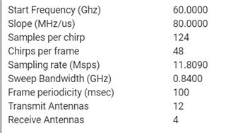

However, when I tried to load this file onto the chip with the Demo Visualizer app, I got an incorrect config error and the Chirp/Frame tab shows that I have configured 12 transmit antennas, which is obviously wrong.
Did I configure it wrong? Any help would be appreciated.

    I have done that for your current configuration and it seems to be okay. I am not sure about the 12 transmit antennas. That seems wrong to me. With 4 RX and 3 TX, you should have 12 virtual RX antennas.
    Second, the sensing estimator only checks your chirp configuration. I would suspect that another parameter you are passing in may be wrong. Can you try comparing your configuration to a default OOB configuration and reporting back what the differences are? We can go from there.

    Sorry I believe I misunderstood your question at first. You are trying to configure different chirp profiles, correct? The 6843 device only supports one chirp profile. The lines below specifically send that profile to each TX antenna.
    chirpCfg 0 0 0 0 0 0 0 1
    chirpCfg 1 1 0 0 0 0 0 2
    chirpCfg 2 2 0 0 0 0 0 4
    Tim
