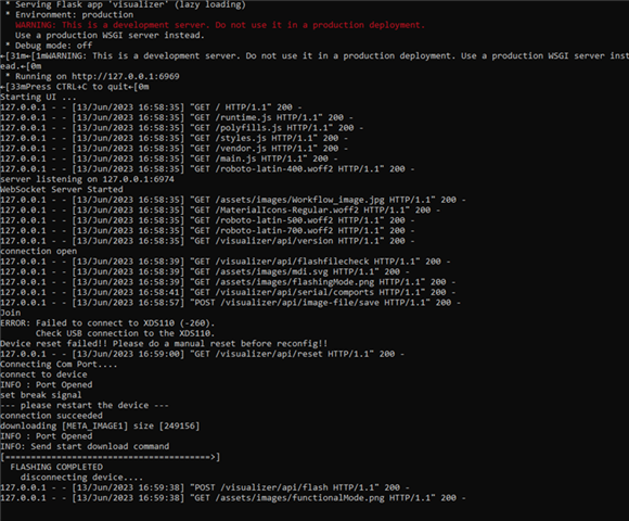

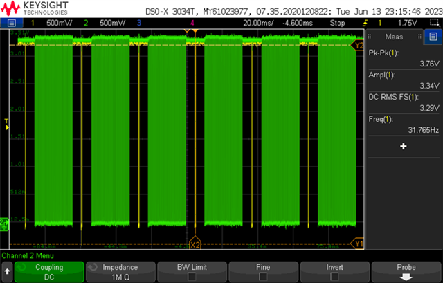

We are not using the XDS110 on our boards. Instead we have our own separate debug board that converts from USB to UART through an FTDI chip. When using the low power visualizer to flash our board, we therefore have to manually specify a COM port as we are not using an XDS. We then flash an .appimage file onto the device, the same one we have been using successfully with the IWRL6432Boost EVM. We are seeing activity on the UART lines (Green is UART-RX and Yellow is UART-TX) when flashing.

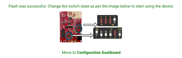

The visualizer then says that flashing has been successful:
I would like to clarify exactly what successful means here:
1. Is there any verification performed to confirm that the .appimage has been stored in external flash successfully?
2. Or does it just write the .appimage to flash and once it has finished writing it just automatically assumes it has successful?
3. Since it says it was successful, can we make the assumption that our external flash we are using on this board is compatible and working as expected? Does the external flash acknowledge that it has received the .appimage successfully?

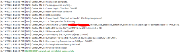

    In the meantime. Have you tried flashing through the standalone Uniflash program? It is generally more verbose with its output as it is flashing the device.
    Tim
  • Hi Tim, I have just flashed it with Uniflash now. Here is the output:
    I would not assume that error checking is being run when you flash the device, but we can forward this to the Uniflash team to comment.

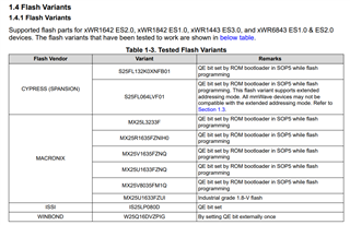

    According to this post, we were not aware that it seems like only MX25V1635FZNQ Flash part is currently supported by the SDK:  https://e2e.ti.com/support/sensors-group/sensors/f/sensors-forum/1237197/iwrl6432-can-the-flash-mx25l3233fm2i-08-be-used?tisearch=e2e-sitesearch&keymatch=IWRL6432%252520Flash#
    We are currently using MX25R1635F (wide voltage part variant). I see that this Macronix Flash IC is supported on other TI platforms:
    Looking at the sysconfig below for the IWRL6432 SDK, it shows that there is only support for MX25V1635F:
    Please could you advise what fields we should change in the sysconfig to make this device compatible with the MX25R1635F? I imagine it should be minimal as the MX25R1635F and MX25V1635F Flash ICs seem very similar.
  • I would not assume that error checking is being run when you flash the device
    Basic (partial/quick) verification is done by UniFlash after flashing the image.
