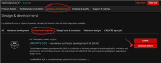

    Please make sure you have installed the latest SDK3 package. You mention you have 'radar_toolbox_1_00_01_07' installed as your SDK, but this is an auxiliary software package and is not the SDK. Find this here: IWR6843AOP

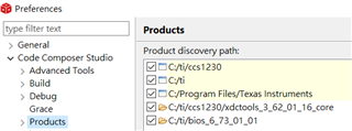

  • Hi Luke,
    Now the issue resolved and compilation completed
    The procedures,
    - Install latest version of CCS V12.3.0
    - Using latest SDK version of radar_toolbox_1_10_00_13
    - By adding path for c:/ti/ccs1230/xdctoold_3_62_01_16_core and c:/ti/bios_6_73_01_01
      See attached picture as following,
    now working project based on
    - PROJECT: Area_Scanner
    - SDK: radar_toolbox_1_10_00_13
    - IDE: CCS V12.3.0
    - EVM:  IWR6843AOP
    - OS: Windows 10
    Thanks again, I would like to close this thread here
