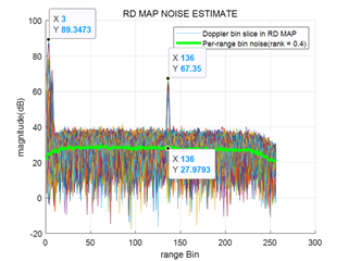

       In AWR2944 ES2.0, we found another strange phenomenon: A near strong detection will increase all range bin & doppler bin's noise. We think this phenomenon is not correct. Would you please help to analyze this phenomenon?
       Some config about RF: the RX gain=24; the HPF config: 175KHz&350KHz
       Test : We use a target simulator to simulate a far range detection in chamber, and after 1D FFT and 2D FFT with windows, we plot the RD map, and calculated the noise of each range bin, and then we add a corner reflector in near range, and maintain the target simulator, and do the same analyze, so that to analysis the near range target's effect about noise level ,and result are as follows:
       Simulator & corner reflector:
       the noise in all range bin is almost same, it's about 27.97dB, and we can see there are two detections in chamber, the near range detection's power is very high. the simulator gain is =-10dB

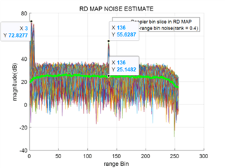

       Only simulator:
        the noise in all range bin is almost same, it's about 25.1dB ,so we can see that noise is reduced 2dB without corner reflector, and all rangebin's noise is reduced, the simulator gain is =-20dB

    I'm not able to see any difference between the two here. The noise floor level is factored in by the simulator gain. Apart from that, I'm not seeing any strange behavior. Could you please elaborate here?

          Thanks for your reply, I forget upload some pictures and test, we also use the same simulator gain and test again:
           the noise in all range bin is almost same, it's about 27.5055dB, and we can see there are two detections in chamber, the near range detection's power is very high,it;s about 87dB , and the far range detection is 55dB, but the noise is also increased to 27.5dB ,  which has 2.35dB increased. the simulator gain is =-20dB

          2. if there are no object, the noise floor is about 22.5dB
