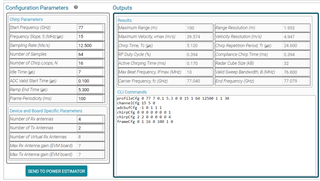

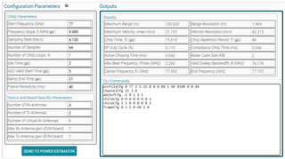

Overview: I am working on a project based on the MRR Lab that needs changing the chirp configuration of the radar front end, so I am using the Mmwave Sensing Estimator Tool (advanced tap) to generate the config file and translating the generated parameters to the MRR config files in the common files section.
  1. However, the generated parameters sometimes crashes the core and is not working at all even when the estimator doesn't give any errors or warnings at all. I am suspecting it has something to do with timing constraints but I am not sure. Is there any limitations/constraints (min/max limits for ADC_Start_Time for example) that I should be aware of?
  2. On the other hand, sometimes the generated configurations work fine but with much higher max_range and max_velocity than expected by the estimator. So is it not very accurate or reliable to use or what might be the source of this issue?
