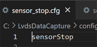

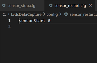

  • Hi, thanks for your reply.
    I saved this code in the PostProc repository then created the datacard_config.json and the .cfg file for the awr2243boost but I don't know if I'm supposed to have the sensor_restart.cfg and sensor_stop.cfg files or create them ? For now, when I run the code with my parameters I get the following error:
    Invalid Command (). error[-4048]
    Unrecognized function or variable 'sendCfg'.
    Error in CLI_OneTimeDataCapture_function (line 60)
    sendCfg(COM_PORT_RADAR_CONFIG, strcat(configFile,'.cfg'));
    I don't know where to find the sendCfg function. Can you help please ?
  • Hi Afaf. The sensor restart cfg and sensor stop cfg can be created such that they contain the start and stop command
