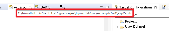

    1. Below is the snapshot of customer's test.
    The test result
    2. Is it only using coordinate information to fit? Is there some document for fitting?
    3. Would you pleas elaborate the specific information for 2^(input/(2^fracBitIn))?  How it is equivalent to 2^x, because all they using is floating point operations.

  • Hi Shine,
    1. The usage seems to be fine and straightforward. Would it be possible to share this standalone test script with me? I can try to connect with the right team to get some more info on this. Please expect a delay in support concerning this.
    2. It uses the bin number or index for the fit. Unfortunately, there is no document explaining this and customers are requested to go through the source code and understand the algorithm.
    3. Let's assume your fixed number has no fractional bits at all. Then 2^(input/(2^0)) = 2^input where x=input. The function here takes input as unsigned integers and returns a floating-point number based on the evaluation.

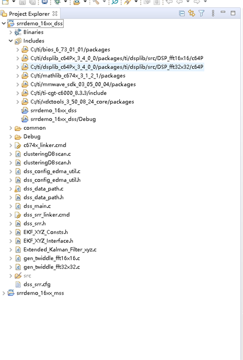

  • Hi Kaushik,
    Below is the customer's reply.
    Sorry for the late response. Below is the demo and SDK version information.
    The lib version:
    Shine
