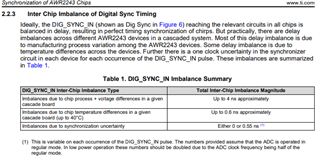

Hi Hiroyuki,
Sorry again for the delay. I have managed to get some more information regarding this.
If software triggered frame is used, it is very difficult to predict the uncertainty. If hardware trigger is used for triggering the frame through Dig_Sync_in pin then you could refer below.
You could refer below appnotes.
https://www.ti.com/lit/an/swra574b/swra574b.pdf
For single chip timing uncertainty is less than 0.55ns, for cascading it could be up to 4ns.
Josh
