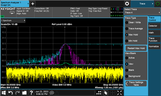

I wanted to check whether there is support for CW mode on TX 2 with MMWAVE_L_SDK_05_02_00_02? I know that CW mode isn't supported in the demo SDK currently, but we have changed the code to get that working and it works without issue for TX 1. TX 2 on the other hand does transmit, but with a far lower power output than TX 1. I just wanted to check whether this is expected with this SDK?

  • Hi Abhiskek, thanks for the reply.
    1. We are using the power optimized mode, as with the IWRL6432 Boost. We have three DCDC Converters supplying the 3.3V, 1.8V, 1.2V.
    2. We have a spectrum analyzer with an external mixer that converts 57 GHz signals down to frequencies our spectrum analyzer can measure.
    We tested our sweep parameters (sweeping from 60 GHz with a bandwidth of approx 60 MHz) on both TXs and we get output powers that we expect. We then put the device into CW Mode (fc = 60 GHz) on TX1 and we got output powers that we expected. We then changed to CW mode on TX2 (fc = 60 GHz) and then all of a sudden the signal seemingly drops below the noise floor of the spectrum analyzer almost as if the TX is off. The only thing we changed was which TX we were using. I'll see if I can get some screenshots to supplement.
    This is a screenshot obtained with the IWRL6432BOOST EVM. Blue trace is our sweep on TX2. Pink trace is CW Mode on TX1. Green trace is CW Mode on TX2, roughly 35-40 dB below TX1.
    We then enabled CW Mode through mmWave Studio and it worked on both TX1 and TX2:

  • Just to follow up, this issue has been resolved. We found out that the ChirpTxMimoPatSel was set to 1. After changing it to 0 (and modifying the code to allow us to do so), we were able to enable CW mode on both TXs.
