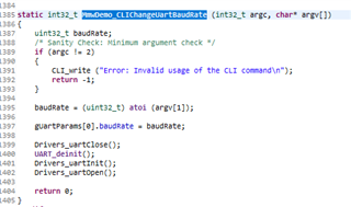

    Here is the function that is being called when we send baudRate 1250000
    There is no evidence of the device being reset. The UART driver is being reset to change the baudrate. I believe that message you see in the console of the visualizer may be wrong, as I see no evidence of the entire device being reset here.

  • Hi, the flow looks like this:
    ・Send a cfg file
    ・The device change the baud rate from 115200 to 1250000 while sending a config
    ・The demo starts
    There is no resetting of the sensor, and you do not need to send a config file twice.
