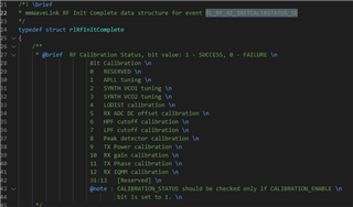

In below terminal, Command looks like send correctly.
But debug message occurs after sensorStart. "Debug: Init Calibration Status = 0xffe".
I can't find the reason.
Please let me know why RL_RF_AE_INITCALIBSTATUS_SB occurs.
