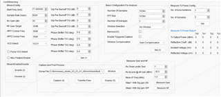

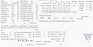

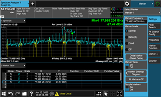

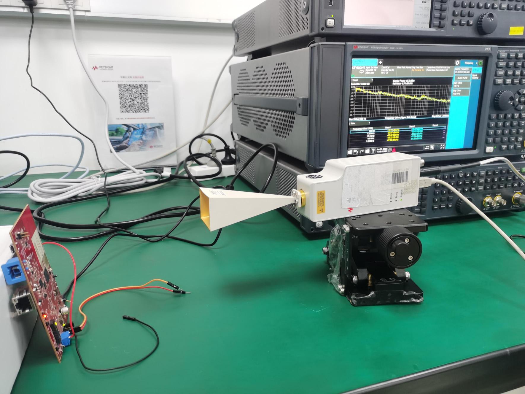

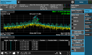

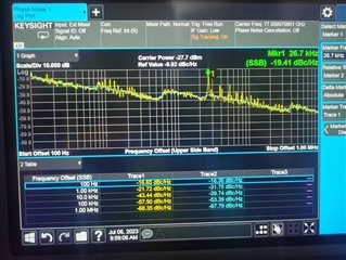

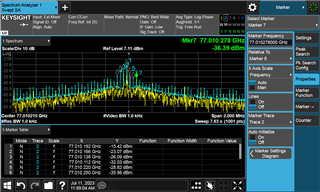

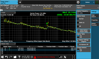

         In awr2944evm, we did the testing of phase noise of CW 78GHz. The measured results do not compliance with the specification provided by datasheet.
These figure show the set up of measurement and the phase noise measured result which is about -60dBc/Hz@1MHz.
