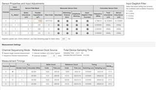

  • STATUS REGISTER VALUE is 0x48
  • Gunil,
    It looks like some bits may be missing from the status register value.
    Is there a 16-bit value available?
    Is the ERROR_CONFIG register set to enable reporting of errors in the output data (bits 11-15)?
    Is it possible to report the first 4 bits of the CHx MSB register as a separate line?
    What is your sensor frequency?
    Can you provide a schematic of your circuit with component vales?
    Can you also provide a full register map?
    John
