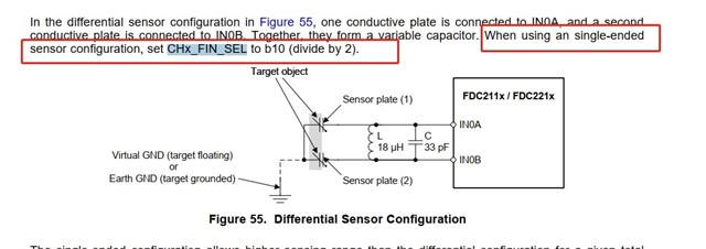

2: Single-ended mode and differential mode software register configuration issues. Before and you have communicated, single-ended and differential, only the hardware wiring way is different. Software does not need to be modified. However, I have seen the specification description. Single-ended mode is to configure the register. Please confirm if this has any effect. Is this configuration necessary?

    2. The assumption behind the text above Figure 55 is that a single-ended sensor has half of the sensor area as the differential sensor.
         That is why the advice is to divide the estimated result by 2.
    3. The data sheet equations (7) - (9) support a computation of the sensor capacitance from the raw output data and some of the other device settings.
    Please see page 17 of the FDC2212 data sheet for the details.
