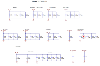

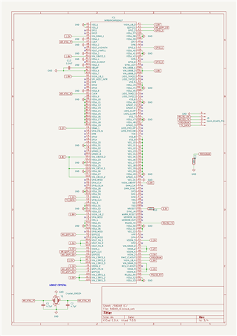

I have developed a PCB with an IWR6843AOP, loosely based around the EVM design board.
I have exposed the following pins:
- Crystal
- Connections for flash ic
- RX/TX
- 2nd UART (TX only)
- SOP (PMIC_CLKOUT)
- GND and power supplies
I have tried flashing the chip using uniflash but I can't get a connection to the chip.
Is there any initial configuration I need to do to the chip before I can flash it?
Have I forgotten to expose some crucial pins?

  • Hello PJ,

    Vout_14synth needs external 1uF capacitor
    Vout_14APLL needs external 1uF capacitor
    There are many mandatory decoupling caps are missing, Please refer below from the EVM schematics
    There are power supply filters are needed to meet the ripple/noise requirement that are not shown in the current schematic.
    QSPI flash need to be compatible with the ROM bootloader with appropriate pull up resistor as per EVM.
    UART port RS232 requires mandatory pull up resistors that are missing.
    Boot /SOP mode (Flashing & functional mode) pins PMIC_CLKOUT, SYNC_OUT, TDO need to have appropriate pull up/down to configure different modes of operation.
    NRESET lines needs cap along with pull up so that, It could be released after the supplies are stable to that it could register appropriate boot mode during the power up.
    NERROROUT, NERROR_IN, WARM_RESET are open drain needs external mandatory pull ups.

  • Hi Chethan,
    Thank you for your reply.
    I have all the decoupling capacitors on another sheet but I can see now that I have left some import pins floating. I will fix my schematic and try again.
