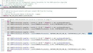

    Appreciate your response. I found in the resource explorer's MRR user guide section that the config is hard coded for MRR module and the file mrr_config_consts.h can be updated to tune the config then the project can be rebuilt to generate the binary. I tried understanding the MRR module and updated some code in the some of the files and now I am getting myself detected as a blue dot(USRR cluster) when I am standing very near like less than 1 meter to the moving machine. Just need to figure out why its not being sent to the tracker so that I get the rectangle around me that will be tracked. Attached images has info on all this.

    3.  Moving radar + static person => No detection or tracking (although in MRR after I changed some code that I mentioned above, I as a static person was inconsistently detected as a USRR object as a blue dot, but still not tracked).
    I tested MRR beamforming and the results are same like we observed in MRR module. I want to update the code like I did in MRR and retest but the beamforming project is not listed in CCS project explorer and the steps in the link that you mentioned, considers MRR module in the instructions for building the beamforming project in CCS.

    • Have you played around with CFAR thresholds to increase the detection probability of a person?
