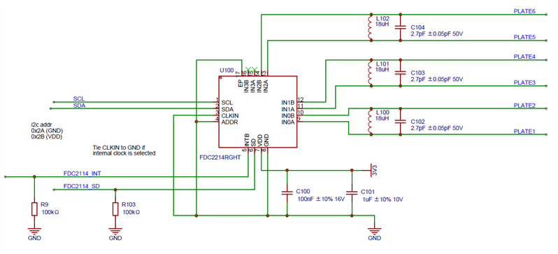

I have an application using CH0 and CH1 for sensing liquid , and CH2 for a reference sensor. All 3 channels are configured with differential sensor plates.  CH0 and CH2 are behaving as expected, but CH1 has some strange behaviour where the readings drift and recover for no apparent reason.
Since CH0 and CH1 are measuring the same vessel of fixed volume of liquid , I doubt it's due to that.  The LC tanks are all the same (18uH and 2.7pF)  and sensor plates same size.   I wondered if the layout and specifically the proximity of ground planes and other signals to the sensor tracks are the cause.
1/ Should the channel signals be "isolated" from other circuit signals by putting a ground plane underneath and along side the channel signals?  If so , how close or how far ? Currently I have minimum track-track clearance between ground plane and the one channel signal.
2/ Please can you confirm which pin (either  CHxA  or CHxB) is the driven output, and the other pin presumably is the input?  (I'm assuming it's similar to a crystal oscillator circuit. ) Currently IN0A is routed next to ground plane and other signals,  while IN1B is routed close to ground plane and other signals.
U100 is the FDC2214 ;  CH0 has L100//C102 and tracks going to the left,  and CH1 has L101//C103 and tracks going to the right.
3/ I would imagine I should put the driven signal next to ground plane and other signals, and the "input" signal away from ground plane/other signals.

  • Hi John,
    Thanks for your comments.  Let me discuss internally, but here is the schematics.  Powered from USB 5V through a 3v3 LDO.
    The interrupt and SD pins are not used nor connected to CPU. I've added series resistances to i2c to try reduce i2c noise when polling for data.
    Plate 5+6  are copper pour on the PCB top and bottom layers - used as a reference compensation.
    Hadyn

  • Thanks Hadyn.
    With the nominal frequencies, inductance and capacitance given here, it looks like the sensors should have about 20pF of capacitance?
    Does this line up with what you expect?
    Interestingly, there is another FDC2112 E2E thread where the sensors are in close proximity, and they are having some issues as well, which may be related to your original question (1).
    In general, capacitive sensors can be a little finicky to PCB routing and parasitic coupling between traces.
    If you can, please try experimenting with some ground plane over and/or between your sensor traces.
    You can't go wrong with more shielding as long as it doesn't cause too much parasitic capacitance.
    Another experiment to try is along the lines of a suggestion in the other thread: different sensor frequencies for CH0 and CH1.
    If you decide to try this approach, then please make them non-harmonically related.
    John

  • Haydn,
    The INxA and INxB pins are both outputs.
    They should both have half-cycle sinusoids displaced a period from one another.
    so if you probed them differentially you should see a full cycle sinusoid.
    John
