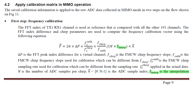

Hi TI experrt,
 By checking the document "signal_processing_4chip_cascade.pdf" under mmWave_Studio_03_00_00_14 (the installed folder below:
C:\ti\mmwave_studio_03_00_00_14\mmWaveStudio\MatlabExamples\ ), we don't understand the definition of "" in end of page #9 description.
 Could TI help to explain it more?
 The PDF document is attached here:
  • Hi Jesse,
    This documentation is quite dated and support will be limited on the same. Users are expected to draw an understanding based on the available documents regarding these algorithms.
    Regardless, I will check internally with the team to see if any additional info can be obtained regarding the same topic and update in the same thread.
