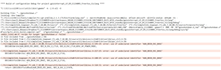

I would like to run shutdown mode by LEFT botton pressed then wakeup mode by the same LEFT button pressed based on board of LP-EM-CC2340R5
Due to not found the shutdown example directly so I try to refer based on C:\ti\simplelink_cc13xx_cc26xx_sdk_7_10_01_24\examples\rtos\LP_CC2652R7\drivers\gpioshutdown
Now I got the compilation failures on the followings,
(1) Picture:
(2) The same as above: in text
**** Build of configuration Debug for project gpiointerrupt_LP_EM_CC2340R5_freertos_ticlang ****
"C:\\ti\\ccs1230\\ccs\\utils\\bin\\gmake" -k -j 8 all -O
Building file: "../gpioshutdown.c"
Invoking: Arm Compiler
"C:/ti/ccs1230/ccs/tools/compiler/ti-cgt-armllvm_2.1.3.LTS/bin/tiarmclang.exe" -c -march=thumbv6m -mcpu=cortex-m0plus -mfloat-abi=soft -mlittle-endian -mthumb -Oz -I"C:/Users/paull_0duwwil/Dropbox/TI_CC2340R5Project/workspace_V0220_CC2340R5_CCS1230_SDK7100035_BLE5_GPIO_standby/gpiointerrupt_LP_EM_CC2340R5_freertos_ticlang" -I"C:/Users/paull_0duwwil/Dropbox/TI_CC2340R5Project/workspace_V0220_CC2340R5_CCS1230_SDK7100035_BLE5_GPIO_standby/gpiointerrupt_LP_EM_CC2340R5_freertos_ticlang/Debug" -I"C:/ti/simplelink_lowpower_f3_sdk_7_10_00_35/source" -I"C:/ti/simplelink_lowpower_f3_sdk_7_10_00_35/kernel/freertos" -I"C:/ti/simplelink_lowpower_f3_sdk_7_10_00_35/source/ti/posix/ticlang" -I"C:/ti/FreeRTOSv202104.00/FreeRTOS/Source/include" -I"C:/ti/FreeRTOSv202104.00/FreeRTOS/Source/portable/GCC/ARM_CM0" -DDeviceFamily_CC23X0R5 -gdwarf-3 -MMD -MP -MF"gpioshutdown.d_raw" -MT"gpioshutdown.o" -I"C:/Users/paull_0duwwil/Dropbox/TI_CC2340R5Project/workspace_V0220_CC2340R5_CCS1230_SDK7100035_BLE5_GPIO_standby/gpiointerrupt_LP_EM_CC2340R5_freertos_ticlang/Debug/syscfg" @"syscfg/ti_utils_build_compiler.opt" -o"gpioshutdown.o" "../gpioshutdown.c"
subdir_rules.mk:9: recipe for target 'gpioshutdown.o' failed
In file included from ../gpioshutdown.c:58:
In file included from C:/ti/simplelink_lowpower_f3_sdk_7_10_00_35/source\ti/devices/cc23x0r5/driverlib/sys_ctrl.h:78:
In file included from C:/ti/simplelink_lowpower_f3_sdk_7_10_00_35/source\ti/devices/cc23x0r5/driverlib/pwr_ctrl.h:70:
C:/ti/simplelink_lowpower_f3_sdk_7_10_00_35/source\ti/devices/cc23x0r5/driverlib/osc.h:195:19: error: use of undeclared identifier 'AUX_DDI0_OSC_BASE'
DDI16BitWrite(AUX_DDI0_OSC_BASE, DDI_0_OSC_O_CTL0, DDI_0_OSC_CTL0_XOSC_HF_POWER_MODE,
C:/ti/simplelink_lowpower_f3_sdk_7_10_00_35/source\ti/devices/cc23x0r5/driverlib/osc.h:217:25: error: use of undeclared identifier 'AUX_DDI0_OSC_BASE'
DDI16BitfieldWrite( AUX_DDI0_OSC_BASE, DDI_0_OSC_O_CTL0,
C:/ti/simplelink_lowpower_f3_sdk_7_10_00_35/source\ti/devices/cc23x0r5/driverlib/osc.h:240:25: error: use of undeclared identifier 'AUX_DDI0_OSC_BASE'
C:/ti/simplelink_lowpower_f3_sdk_7_10_00_35/source\ti/devices/cc23x0r5/driverlib/osc.h:324:31: error: use of undeclared identifier 'AUX_DDI0_OSC_BASE'
return (DDI16BitfieldRead(AUX_DDI0_OSC_BASE, DDI_0_OSC_O_STAT0,
Here working project based on,
- PROJECT: C:\ti\simplelink_lowpower_f3_sdk_7_10_00_35\examples\rtos\LP_EM_CC2340R5\drivers\gpiointerrupt
- EVM: LP-EM-CC2340R5
- SDK: simplelink_lowpower_f3_sdk_7_10_00_35
- IDE: CCS V12.3.0
- OS: Windows 10

  • Hi Kevin,
    Based on the build log it appears that you have referenced a TI-RTOS7 CC2652R7 example for your Free-RTOS CC2340R5 project.  These RTOS versions are incompatible and my recommendation is that you import the CC2340R5 gpiostandby project, confirm that the build succeeds, and then compare the differences between the gpiostandby and gpioshutdown projects before applying the necessary changes to your base CC2340R5 gpiostandby project.  Here is a Quick Start Guide to help you set up your environment.
    Ryan
