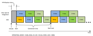

Now we have question for continuous mode. I see registers and if understand well 010b = 2h, in active measurement mode is always low power mode time delay. So this mode is for our purpose (motor commutation )  not good because we have 1ms regulation loop. Minimum time of low power mode between measurement is same 1ms. Do I understand it well?
Then I have to use Trigger mode, start conversion on CS pulse. Then I can achieve without filtration 13.3 ksps for 2 channel (angle) sensing, Am I right?
  • Karel,
    This appears to be a typo.  The SLEEPTIME setting applies when OPERATING_MODE is set to 100b (4h) .  In active measure mode, the next conversion will start immediately after the preceding conversion.  The conversion cycle will follow this pattern:
    You should be able to achieve the following sample rates with continuous conversion set:
    If averaging is enabled (2x - 32x), the temp conversion (T_RATE) should be set to once per conversion set to achieve the rates shown above:
    Scott

    we are still discussing here, what configuration would be best sensor setup for motor control application. Our motor control application needs to get in 1kHz rate fresh position value. Speed is then computed as numerical differentiation of position, which always brings challenges: To get quality speed signal it is needed low noise and high resolution in position signal. Another issue is, that for speed feedback control is signal time delay always killer. From above requirements: We would like to get angle value in fixed rate 1kHz, angle value computed from highest highest possible count of averaged samples in best possible resolution (12bit?), captured in last 1ms. Angle value in best possible resolution (13bit or 12bit over SPI?)
    Can you advice us, how would be possible to set the sensor? Continouous mode? Or trigger mode with everaging in MCU?
    So there is question for averaging if I use internal classsical AVG filter of TMAG or I will create better filter (window filter).
    By the way, Im a litte confused with 7.5.1.4 Angle and Magnitude Data Definition, there is 1/16 and 1/4 resolution from cordic. So, how can I achieve 1/16 resolution?
    Can we do some small call for better understanding?
    Thank you very much
  • Karel,
    You may use 1x-32x averaging while in continuous mode and not just during wake and sleep mode while using the Alert pin as a trigger.
    Another setting at your disposal is to set the sampling pattern to account for sampling latency of the device.  Since the axes are sampled serially, measuring angle at speed can produce non-linearity.  The device allows you to set the pattern to XYX which will average an x result immediately before and after the Y conversion.  This is referred to as pseudo-simultaneous sampling in the datasheet.  This particular pattern would use the same conversion time as XYZ.
    So, if you need fresh data at a 1 KHz rate, we need to set the sample pattern above 1 Ksps.  In XYX mode you could set averaging as high as 8x and still have new data for each sample.  In Just XY mode, you could set the averaging to 16x.
    The integrated CORDIC has a resolution of 1/4 degree at the output.  To achieve 1/16 degree you would need to read the raw X and Y channel data and then perform the arctangent calculation in your MCU.
