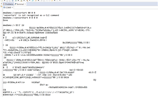

    We have tried as you specified like, sent all the config params through the UART with 115200 baudrate and sent the 'baudRate 1250000' CLI command then switched the UART terminal baudrate to 1250000 and given  'sensorStart 0 0 0 0' CLI command as shown below. After that the UART terminal is like shown below. It is been printing these special symbol or characters continuously as shown below. When we are paused the session, the program flow is inside a function UART_readPolling() and then go to UART_RxRdy() and looping around the UART_RxRdy() function. Have you encountered anything like this?

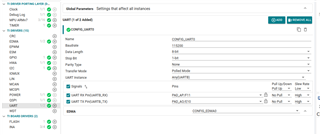

    And one more doubt. In the example.syscfg there is an option for baudrate. Is this depended on our program????
    Sreekesh Giri
  • Hey Sreekesh,
    For the UART output, it is outputting the TLV data which contains information such as detected points, heatmap data, etc.. You can read more about the UART output and TLVs in the following Radar Toolbox guide:
    https://dev.ti.com/tirex/explore/node?node=A__ADnbI7zK9bSRgZqeAxprvQ__radar_toolbox__1AslXXD__LATEST&placeholder=true
    If you would like to parse this TLV data, you will either have to add your code to the demo code or you can run the Industrial Visualizer in the Radar Toolbox - found under <RADAR_TOOLBOX>/tools/visualizers/Industrial_Visualizer - and check the "Save UART" box. For the Industrial Visualizer, it will output .bin files every 100 frames to the binData folder in the same directory as the visualizer. You can then use the parseStandardFrame function from parseFrame.py to parse the .bin file. I've included a Python script I threw together that will pull in a file and decode all of its frames - though it does nothing with the decoded TLV data.
    It is normal that the program is polling the UART while sending TLV data so there's nothing going wrong on that part. If the program is getting stuck in a DebugP_assert statement or Hwi interrupt after pausing the program, this is likely due to the power management task that checks whether or not the device can enter low power mode amongst other conditions. This can be fixed by setting the lowPowerCfg to 2 when sending over the CLI commands which will emulate that check but prevent any assertion issues.
    For the SysConfig, the Baudrate parameter is used to set the initial baud rate for the device. The baudRate CLI command will overwrite the device's baud rate regardless of the initial setting.
