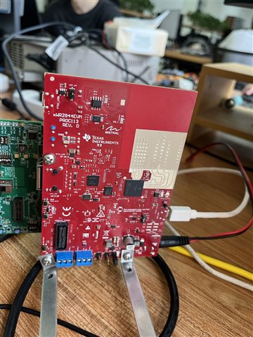

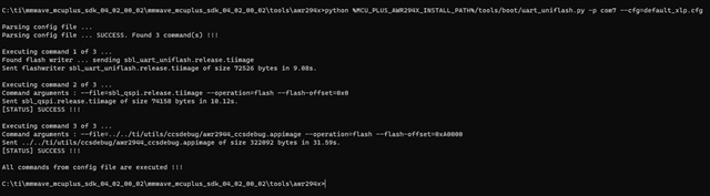

  1. in sop[2:0]=101  UART Boot Mode, the customer use python script to download these three image: sbl_uart_uniflash.release.tiimage, sbl_qspi.release.tiimage, ti/utils/ccsdebug/awr2944_ccsdebug.appimage
  2. in sop[2:0]=001  QSPI Boot Mode, open Code Composer Studio, create a 2944.ccxml target configuration to debug own app code, they can just connect cotex_R5_0, the other two core cannot be well connected.
How to connect these core well and to debug their app code?
By the way, they changed the SDK to mmwave_mcuplus_sdk_04_03_00_01,and use the same way to flash images, they can connect coretex-r5_0 and dsp (not connect coretex-r5_1). When using mmwave_mcuplus_sdk_04_02_00_02 , only coretex-r5_0 can be connected.
Could you help check this case? Thanks.
