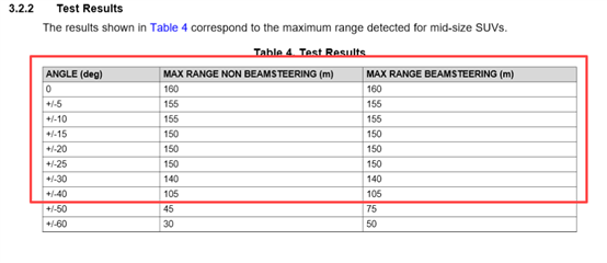

We checked from the design guide "Beamsteering for Corner Radar Reference Design", and the test result for max range non beamsteering and beamsterring is the same while angle less than 40 degrees.
https://www.ti.com/lit/ug/tiduev0/tiduev0.pdf?ts=1689312359294&ref_url=https%253A%252F%252Fwww.google.com%252F
If non beamsteering mode is MIMO mode with TDM, it does not make sense to have the same detection ability as beamsteering mode.

I guess it is not MIMO mode by TDM (AWR1843 EVK), it should transmit TX1 & TX2 & TX3 at the same time to get the longer detection range.
But the HFOV should be narrow by transmit TX1 & TX2 & TX3 at the same time, thus, +-40 degrees keeps the same range detection as beamsteering mode, it does not make sense as well.
