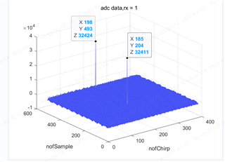

     We meet a problem about a abnormal value in adc data.
    Scenario:: A car has two radars, one on the front right with an upper chirp (positive slope rate) and the other on the front left with a lower chirp (negative slope rate), and we find that in the adc data of the radar, there is a very large value that is almost saturated, this value is about 30000, this outlier is present in almost every frame

          Thanks for your apply, there are some updates: if only one radar active, it still has this phenomenon: has a abnormal value in adc data. Why does this abnormal value generated?

        We collect about 300 frames, almost all the frames have abnormal value, but one frame may only has 1/2 abnormal value
        In case of only one sensor:
    1. Is it always happening on the same sample or a different sample? (Where sample is the bin number of the ADC data):
             It happening in different sample(I think it's random)
    1. Does it occur if you change the device sample or another EVM?
             Yes, it occurs in different device  sample
    1. Are you using TI EVM or your custom board?
             We are using our custom board
    1. Are you observing this phenomenon if you change your scene?
             We meet this phenomenon in other scene
    1. Are you able to see this spiked ADC data if you change your chirp design (say slope or bandwidth by a small degree)?
             Currently we didn‘t change the chirp design, but if we have chance, we will try it.
    1. Have you streamed the data via LVDS using the demo or mmWave Studio?
           Yes, we streamed the data via LVDS
