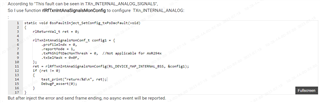

According to "This fault can be seen in TXn_INTERNAL_ANALOG_SIGNALS",
So I use function rlRfTxnIntAnaSignalsMonConfig to configure  TXn_INTERNAL_ANALOG:
static void BssFaultInject_SetConfig_txPsDacFault(void)
    rlReturnVal_t ret = 0;
    rlTxnIntAnaSignalsMonConf_t config1 = {
        .profileIndx = 0,
        .reportMode = 1,
        .txPhShiftDacMonThresh = 0,  //Not applicable for AWR294x
        .txSelMask = 0x0F,
    ret = rlRfTxnIntAnaSignalsMonConfig(RL_DEVICE_MAP_INTERNAL_BSS, &config1);
    if (ret != 0)
        test_print("return:%d\n", ret);
        DebugP_assert(0);
But after inject the error and send frame ending, no async event will be reported.
