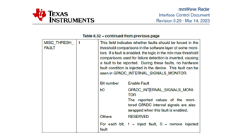

    I noticed that the fault miscThreshFault have only one bit valid(bit0 GPADC_INTERNAL_SIGNALS_MONITOR) in the last version DFP(mmwave_dfp_02_04_08_01). The detailed description is as below:
         * @brief This field indicates whether faults should be forced in the threshold comparisons \n
                   in the software layer of some monitors. If a fault is enabled, the logic in the \n
                   min-max threshold comparisons used for failure detection is inverted, causing a \n
                   fault to be reported. During these faults, no hardware fault condition is  \n
                   injected in the device.
                   This fault can be seen in GPADC_INTERNAL_SIGNALS_MONITOR. \n
                    Bit Enable Fault
                    0  GPADC_INTERNAL_SIGNALS_MONITOR \n
                    The reported values of the monitored GPADC internal signals are also swapped \n
                    when this fault is enabled. \n
                    Others RESERVED
                    For each bit, 1 = inject fault, 0 = remove injected fault.
        rlUInt8_t  miscThreshFault;
    and the DFP version  I used is mmwave_dfp_02_04_06_00.
    So I guess the fault injection also don't support bit1 of miscThreshFault, could you confirm it.
    Let me check the code and documentation and get back to you on this.
    Pradipta.
    The comment description in the SDK needs to be updated. The ICD reflects the correct description for this bit as below. Also you got the event related to GPADC_Internal_Signals_monitor.
    External Analog Signals is not valid here.
    Pradipta.
