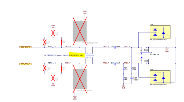

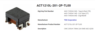

May you help check the L7 P/N on AWR2944? I see the BOM list and BOM list shows the P/N is ACT1210L-201-2P-TL00.
But it looks like that the L7 on EVM  is not ACT1210L-201-2P-TL00. I also find the comments in schematic.
Can you help check the L7 P/N for me?
I asked because we used  ACT1210L-201-2P-TL00 on our board and ethernet PHY(812) can't work well. But we swapped the CMC(L7)(EVM's L7) to our board, our board can work. So we doubt that the L7 on EVM board isn't  ACT1210L-201-2P-TL00.
