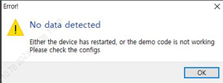

Now I have an unexpected issue, then I need help from you.
I have been developing IWRL6432 product.
I have mentioned several times that I made my own custom board of 6432 by modyfing its EVM.
To find out optimized cfg for my application, I edited its configuration from motion detection cfg offered in SDK 5.1.
(I guess SDK version is not related with this issue)
As following, I attached my cfg,

As you can see, there is only few differences.
But suddely, visualizer is stopped with error when I send my cfg.
Whether my board or EVM, the same result comes out.
I am confused because there was no problem until I figure out the values using visualizer.
Furthermore, detection data output is out and main MCU take it.
I have no idea what the problem is in this situation.

    What modifications to the board did you make?
    Which visualizer are you using? What errors are you seeing in the visualizer?
    Can you send some screenshots of what you are seeing?
    You're saying a separate MCU is able to read data over UART?

    *Modification
    - I just made my board with only minimum part to operate radar sensing(6432, DCDC, QSPI flash, RLCs, LED) being the same as EVM.
    * Visualizer version
    - I use visualizer in SDK version of MMWAVE_L_SDK_05_01_00_04.
    * Error Screen shot
    - Image as below
    * MCU
    - I use ST MCU as main function and receive radar data(UART) from 6432.
  • Now, I guess I find out the cause of the error issue.
    I changed cfg parameter frome attached my cfg(in the question thread) only FramePeriodicity in frameCfg command(150 to 200).
    After that, I have had no more error.
    I assume,
    Required performance to signal processing exceed against how 6432 can when the frame rate is too fast.

    I am happy to here that you found modifying FramePeriodicity would make the chip work. I've put your configuration (with 150ms Frame Period) into our sensing estimator tool: https://dev.ti.com/gallery/view/mmwave/mmWaveSensingEstimator and it is giving me an error as an invalid configuration:
    "With the xWRL6432/1432, burst idle time, which equals burst periodicity - numOfChirpsinBurst(idleTime+rampEndTime)), must be greater than 115µs. Currently it is 82µs. Increase burstPeriodicity, or decrease numOfChirpsinBurst, idleTime or rampEndTime"
    I highly suggest using the sensing estimator tool when constructing your .cfg files so you know that the values you are putting into the device are feasible.
