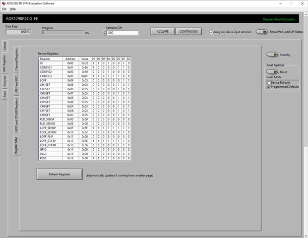

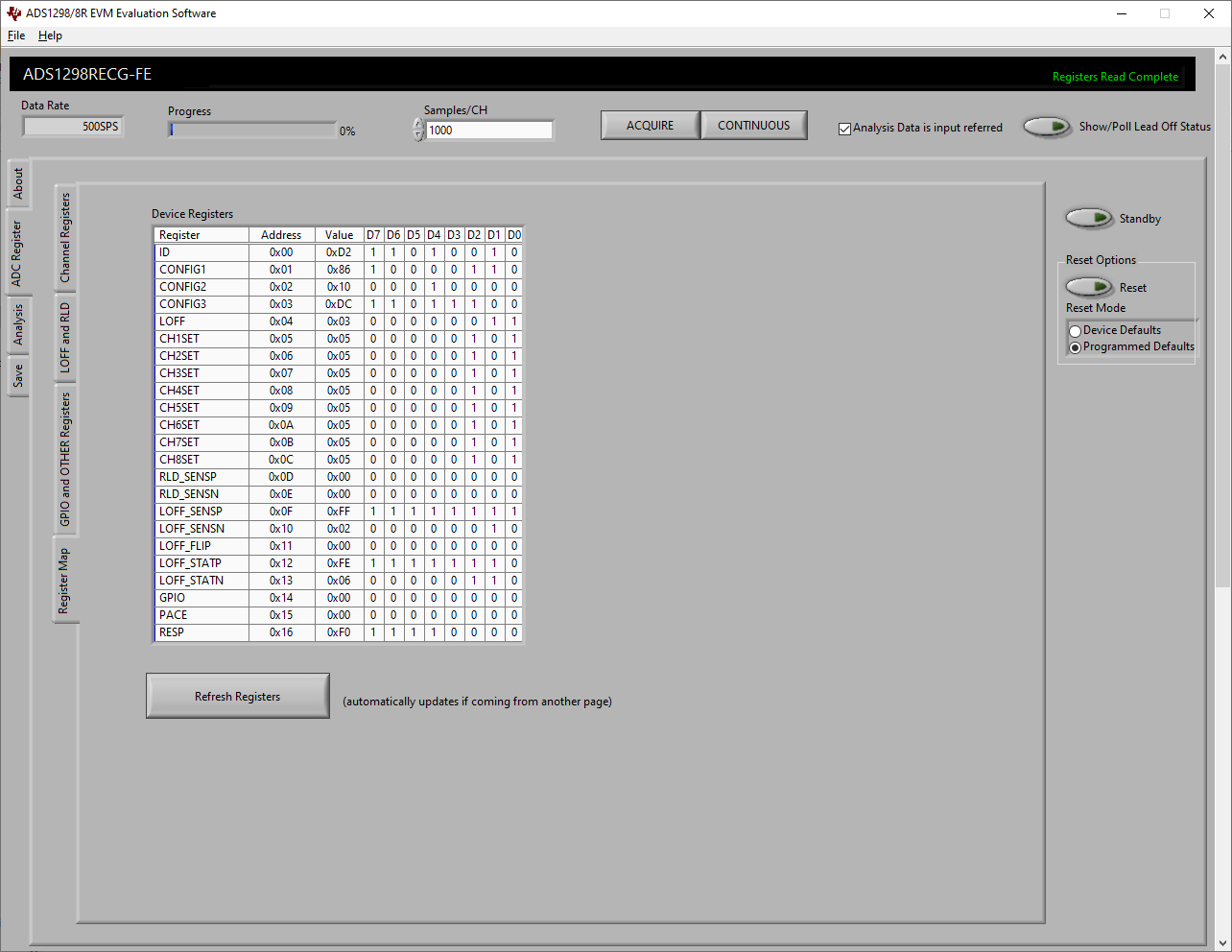

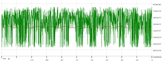

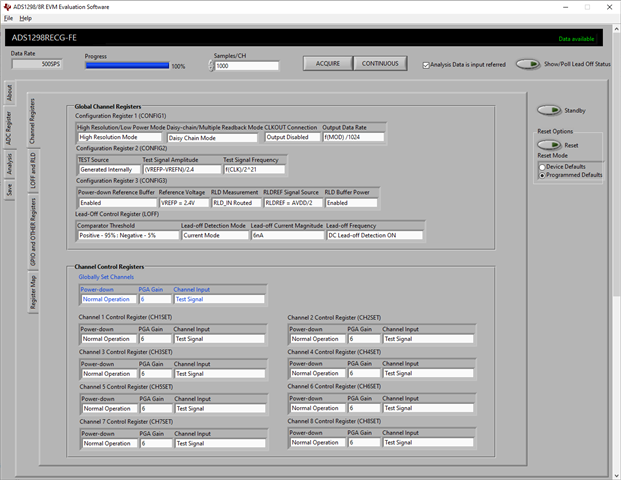

  At present, the ADS1298R is used in the evaluation. The breathing signal can be seen through real-time data, but the heart rate signal is noisy.

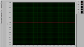

1.  The noisy signal in ch2 still exists when there is no external RA&LA or short RA&LA.
  We are also using the ADS1298RECGFE evaluation board, and we have also seen some filtering information in companion applications.
  When we disconnect the RA&LA lead, the signal in ch2 is flat.
2.  Does this part of the resistance-capacitance value adjustment affect the amplitude of the ECG signal? How to adjust
