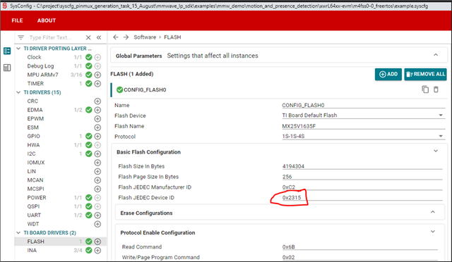

    I am attaching snapshots of steps to generate a new build of appimage that should support the MX25R1635F flash memory and the generated appimage file.
    1. Open sysconfig tool using the command.
    • gmake -s -C examples/mmw_demo/motion_and_presence_detection/xwrL64xx-evm/m4fss0-0_freertos/ti-arm-clang syscfg-gui

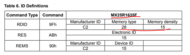

    2. Change the device ID to 2815 for MX25R1635F. And save the SYSCONFIG file.

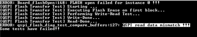

    I followed the steps you suggested and ran the qspi_flash_transfer project, but I got an error. The error message is "QSPI read data mismatch!!!" and the likely cause of the error is Flash_write or Flash_read function.

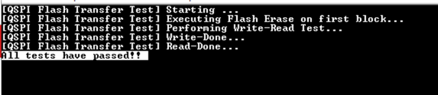

    The device ID might not have been changed in the QSPI flash transfer appimage, which could be the cause of the QSPI data mismatch issue. Both the ATE_calibration and the motion and presence detection demo should function when the updated appimage has been flashed on the device.
    Please Flash the device with the below QSPI flash transfer appimage.
    https://e2e.ti.com/cfs-file/__key/communityserver-discussions-components-files/1023/qspi_5F00_flash_5F00_transfer.release_5F00_2815.appimage
    Once done you should see all the tests passed.

    I flashed the attached appimage and tried to run "QSPI flash transfer", but I got the same log as before.

    The device ID only needs to be updated for qspi_flash_transfer & OOB demo appimages. Please do check using the SYSCONFIG tool if the device ID in (appimage/sysconfig) file matches with the ID specified in the datasheet of the QSPI Flash.
