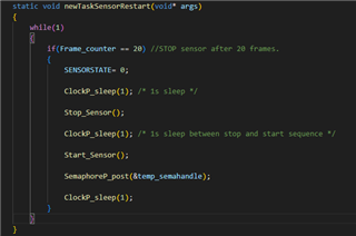

    We want  successive sensor starts and stops by issuing a command/ or calling a function without change in Config.
    When the sensor stop command is issued the RF should stop chirping so should the processing. When a sensorstart
    command is issued again, the chirping should resume followed by processing of data.
    We have tried the implementation suggested by you by -
    1. removing CLI,
    2. hardcoding the Configuration,
    3. creating a newTask only once with priority 1 (lower than dpc and transmit tasks). This task contains the sensor stop, delay and sensorstart functions called in condition check if numFrames is equal to 20 , enclosed in an infinite while loop.
    4. We created a gloabl variable, SENSORSTATE, which is set to 0 when sensor stops and 1 when sensor starts.
    5. We are halting the DPC by using this SENSORSTATE variable and a pend.
    6. This pend is posted right after the sensor start command is issued in the new task.
    Observation: The sensor starts, code runs fine for 20 frames, sensor stops, but the control never comes to DPC again as it seems to be stuck in here -
    Can you please let me know what changes need to be made to ensure that the execution reaches DPC again after MmwDemo_startSensor() is successfully executed.
    Thanks and Regards
    Bodhit Gupta

    In the new Task, i changed the SENSORSTATE to 0 and gave a delay of 1 sec(screenshot 1) so that the control goes to the semaphore pend in dpc_task(screenshot 2).
    Screenshot 1
    Screenshot 2
    As soon as this breakpoint(line 3743) at pend is hit in dpc task, I do a step over.
    My expectation is that the execution should go back to newTask but instead it goes into hard fault exception (right after the step over after pend in dpc task.)
    Please help me understand why does the flow go to hard fault exception and how do I cleanly start and stop the DPC.
    Thanks and Regards
    Bodhit

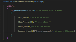

  • Hello Bodhit,
    Can you please show me how you are creating temp_semahandle. Are you using SemaphoreP_constructBinary or xSemaphoreCreateBinaryStatic to create the temp_semahand?
    If you are defining temp_semahandle in a different file, are you using extern TaskHandle_t temp_semahandle to make the temp_semahandle visible in the file you are pending in?
    Luke
  • Hi Luke,
    Thankyou for the response.
    I had "temp_semahandle" declared only as a semaphore object but once I  use SemaphoreP_constructBinary  for the same, the execution reaches the new Task again without any hard fault exception now. i am able to do a stop followed by a start and a post to dpc execute.
    After restarting the sensor again, followed by a post to dpc_task, I put breakpoints in dpcexecute to check if i am able to access DPC.
    I am able to put breakpoints in dpcexecute but  as soon as i step over and reach the call to doppler_process(), the execution gets paused again.(screenshot1)
    Screenshot1
    When i check in the ccs to find where the execution is getting paused, i find it to be in the while(1) loop in the newTask that we created.(screenshot2)
    Screenhot2
    I am not able to understand this inspite of keeping the priority of the new Task to be lowest(1) and even same as transmit task(3).
    Please help me understand why this is happening and how can it be fixed.

  • For reference, it was determined that the sensor stop function was freeing the DMA channels, however they were not added back when starting the sensor again. Correcting this resolved this particular issue.
    Clinton
