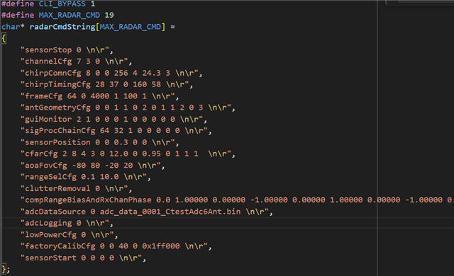

    1. Config used : I am using the BYPASS_CLI to start the sensor automatically without giving any Config through Visualizer. The configuration values for this have been taken as it is from "parking_5m.cfg", Except "lowPowerCfg" made to 0 and "baudRate 1250000" command removed.

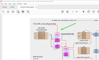

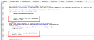

  • After further investigation, the occasional differences in the detection matrices is likely do to the chirping activity continuing and triggering EDMA transfers that overwrite some of the injected data. I’ve indicated this in the “Range DPU block diagram” figure below with a green arrow.
    A potential way to avoid this is to disable the EDMA transfers around where the radar cube data is injected and the detection matrix is saved. This can be accomplished by adding the code highlighted in red below around where the breakpoint has been added to inject the radar cube. After this injection, step over and save the detection matrix.
    From: MMWAVE_L_SDK_05_03_00_02\docs\ MotionPresenceDetectionDemo_documentation.pdf - page 13:
    From mmwave_demo.c:
    Clinton
