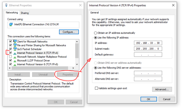

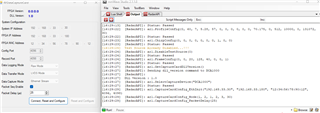

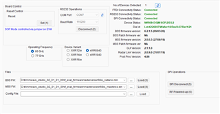

I am using DCA1000 with IWR6843-ODS and MMwaveICBoost. I did all the connections in mmwave studio until I put the chirp parameters then when I push the "SetUp DCA1000" push button on the left, the new window open and I push "Connect, Reset and Configure" but the FPGA version is not updated to 2.8 as usual. in the output log I got that  and the FPGA is not connected and it does not show any error
[12:55:48]  [RadarAPI]: ar1.GetCaptureCardDllVersion()
[12:55:48]  [RadarAPI]: Sending dll_version command to DCA1000
[12:55:48]  DLL Version : 1.0
[12:55:48]  [RadarAPI]: ar1.SelectCaptureDevice("DCA1000")
[12:55:48]  [RadarAPI]: Status: Passed
[12:55:49]  [RadarAPI]: ar1.CaptureCardConfig_EthInit("192.168.33.30", "192.168.33.180", "12:34:56:78:90:12", 4096, 4098)
[12:55:49]  [RadarAPI]: ar1.CaptureCardConfig_Mode(1, 2, 1, 2, 3, 30)
[12:55:49]  [RadarAPI]: ar1.CaptureCardConfig_PacketDelay(25)
I have flashed the FPGA and the Firewall is disabled. Also, I have already been using it successfully on the same PC before but suddenly it stopped.
