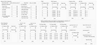

Dear Josh Wyatt
I have already read the mmwave_dfp_user_gudie. I want to know if I can achieve the electronic scan on the mmwave studio? Because the mmwave stduio is GUI that it's convenient to use.
xu sen
Dear Xǔ sēn -
The mmWave Studio has an Advanced Chirp Configuration tab that you can use with the DFP User Guide instructions.

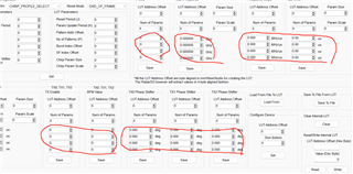

Dear Josh Wyatt
I want to know why the TX Phase Shifter and other parameters have four parameters that we need to configure.
For example, I circle it in the picture.
The reason of this is that the advChirpCfg is used in the cascade solution?
Xu sen
Hello Xu Sen,
Please review C://ti//mmwave_studio_03_00_00_14//mmWaveStudio//Scripts//Cascade folder for beamforming settings.
Review the cascade scripts provided in the mmwave studio release
Please also see the phase shifts introduced in the script of Cascade_Configuration_TXBF_Simple
Hope this helps,
