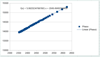

We have a design involving OPT3101 for distance measurement. So we got the EVM board to learn how to do the calibration before the calibration on our own design.
We had the crosstalk_temperature and phase_temperature calibration done on the EVM board but the phase_ambient light calibration seems not reasonable.
Could you help to confirm the crosstalk_temp and phase_temp calibration result is properly?
The below picture shows the crosstalk vs temperature and phase vs temperature graph by OPT3101_SDK.
And then I calculated the coeff. as the SBAU310 mentioned.
Multiply the xtalk vs temp slopes with 2^(-5+SCALE_TEMP_COEFF_XTALK) for the xtalk_temp coeff.
The phase_temp is calculated by .
Could you advise what the values are for SCALE_TEMP_COEFF_XTALK and SCALE_PHASE_TEMP_COEFF?

  • Hi Paul,
    I apologize for the late reply on this.
    To get SCALE_TEMP_COEFF_XTALK, first find the slope of in-phase IPHASE_XTALK and quadrature phase crosstalk QPHASE_XTALK component versus temperature, then multiply that value by 2^(-5+SCALE_TEMP_COEFF_XTALK), but choose the SCALE_TEMP_COEFF_XTALK such that the result is between -128 and 127.
    SCALE_PHASE_TEMP_COEFF should be chosen similarly by measuring the slope of phase (PHASE_OUT) vs temperature (TMAIN), and multiplying that result by 2^(10-SCALE_PHASE_TEMP_COEFF), but choose the SCALE_PHASE_TEMP_COEFF value such that the coefficient is maximum but < 2047.
