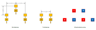

I have a IWRL6432Boost board. I will test the board with a conor reflector.
Which point of the board should be matched up with the center of the conor reflector?

The corner reflector should be aligned with the array center of board in both azimuth and elevation direction. The array center combines both TX and RX antennas.

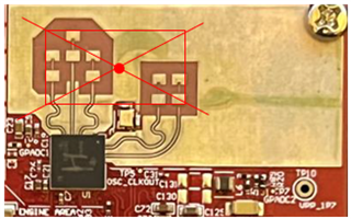

You mean that the center of the conor reflector should be the center of the sqare at below picture?
